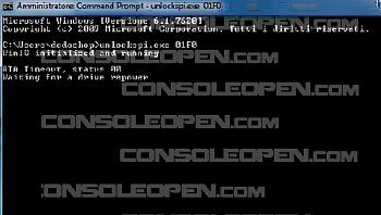

    THIS IS THE CLASSIC PROBLEM THAT IS PRESENTING THE TOOL OF GEREMIA, ON SOME MOTHERBOARD WITH STUBBORN CHIPSET:
    Once you launch the tool as you see you get this status or the status of continuous 0x51:
    The only thingto stabilizethe whole thing is:

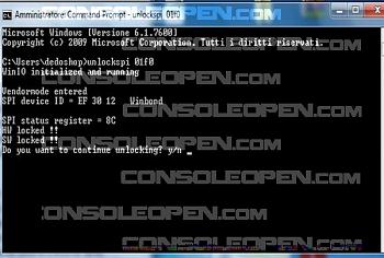

    Restart the PC
    Turn on the Dvd Drive and, when PC is started, run "dosflash32 1.9"
    Make sure to finish the cycle devices detection without any problem and without dosflash ask us to power cycle the driver
    Run, another time, the Geremia's Tool without turn off the Dvd Drive and resend command
    Codice:
    unlockspi sata_port
    As you can see, now the state of the Dvd Drive is OK, and you are ready to do the unlock the Winbond following THIS GUIDE.
