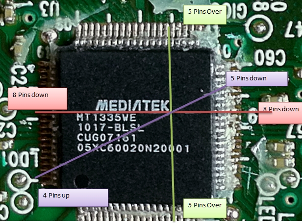

We will have to dig into the MT itself, to get ther right spot Geremia helped us with a nice image:
On a cleaned up MT (use hot air or some other method to get rid of epoxy), use a ruler and a needle to sign the spot:
When you are done with the coordinates MT, get a 100 ohm resistor, smd or ceramic, doesn't matter, solder one side to 3,3 volt and the other to a wire (i used AWG30):
Strip down the wire to form a loop around the engraving cutter, we need 3,3 volt on it while carving:
We will carve like this (after plugging power and sata):

Proceed slowly and with caution , once you reach WP trace you will hear the sound, this will tell you to stop immediately and look at the dos prompt :
Unlock is done, tecnically you just cutted winbond WP's permanent ground connection and simultaneously sended an high signal, geremia's tool, thank to that situation, wrote on status register unlocking the winbond permanently.
