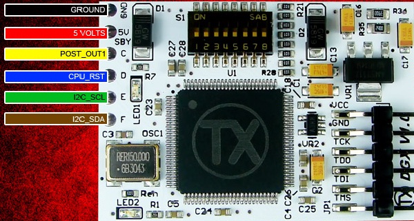

At this point we can install the DGX chip. The points are all the same as other glitchcip with the exception of power source 5V instead 3,3V, it's advisable to use thicker cable then AWG30 for better timing.

As said before, the other points are the same of any classic glitchip, if you are not familiar witch TX coolrunner naming:
C- Post
D- CPU RESET
E- SCL
F – SDA
GND - Ground
Now we have to set the switches on DGX to fit the different motherboard revision:
-all ON for Corona
-from 1 to 7 ON and 8 OFF for Trinity
