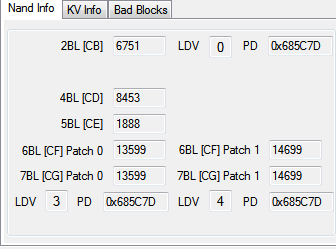

Ciao raga, sto moddando una jasperv2 con dash 14699
tool usato: j-runner
ho letto 4 volte la nand e tutto bene, cb 6751
ho installato il coolrunner rev.B ma non parte niente.
Installazione perfetta, saldature tutte calde.
Quando accendo non si si illumina il led verde che normalmente dovrebbe illuminarsi
ecco il report di j-runner:
Jasper 16MB Big Block
Reading Nand to C:\Users\Marco Alien SSD\Desktop\RESET GLITCH HACK\J-Runner v02 Beta (268) Core Pack\output\nanddump1.bin
Reading Nand
Done!
Reading Nand to C:\Users\Marco Alien SSD\Desktop\RESET GLITCH HACK\J-Runner v02 Beta (268) Core Pack\output\nanddump2.bin
Initializing Nand..
Reading Nand
Nand Initialization Finished
Done!
Comparing...
Nands are the same
* unpacking flash image, ....
ECC'ed - will unecc.
UnECC'ed
A donor version will be used with this CB
* found decrypted CD
* found XeLL binary, must be linked to 0x1c000000
* we found the following parts:
SMC: 2.3
CB_A: 6750
CB_B: missing
CD (image): 8453
CD (decrypted): 8453
* this image will be valid *only* for: jasper (CB_6750)
* patching SMC...
Patching Jasper version 2.3 SMC at offset 0x12BA
* zero-pairing...
* constructing new image...
* base size: 70000
* encrypting CB...
7B67DFF4AE33BEEDB39398E8D6CCDE44
* encrypting CD...
* No separate recovery Xell available!
* Flash Layout:
0x0..0x1FF (0x200 bytes) Header
0x200..0xFFF (0xE00 bytes) Padding
0x1000..0x3FFF (0x3000 bytes) SMC
0x4000..0x7FFF (0x4000 bytes) Keyvault
0x8000..0x11A3F (0x9A40 bytes) CB_A 6750
0x11A40..0x17A3F (0x6000 bytes) CD 8453
0x17A40..0xBFFFF (0xA85C0 bytes) Padding
0xC0000..0xFFFFF (0x40000 bytes) Xell (backup)
0x100000..0x13FFFF (0x40000 bytes) Xell (main)
* Encoding ECC...
100%
------------- Written into output\image_00000000.ecc
Arm Version: 3
Flash Config: 0x00023010
Writing Nand
Done!
avete delle soluzioni in merito? in questo istante sto provando a riflashare la nand originale per vedere che succede :/
