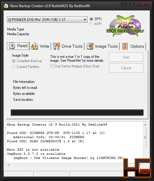

    Xbox Back-up Creator 2.9 build 0421
    Lo sviluppatore Redline99 rilascia na nuova versione del tool XBC versione 2.9 build 0421!
    Noto programma per il Rip dei giochi Originali e Patch delle Iso.
    Ecco il ChangeLog
    Xbox Backup Creator v2.9 Build:0421 by Redline99
    Added – support for OEM VAD6038
    Added – support for OEM TS-H943A
    Added – support for OEM Hitachi GDR-3120L 32, 36, 40, 46, 47, 58, 59, 78, 79
    Added – support for OEM Liteon DG-16D2S
    Added – support for OEM Liteon DG-16D4S
    Added – support for OEM Hitachi DL10N
    Added – support for Drive Key Lookup via Jungle Flasher Key DB
    Added – support for Xecuter X360USB Pro v2
    Added – support for OEM XGD1, XGD2, XGD3 ripping *
    Fixed – SS file save bug
    * OEM Ripping is dependent on using the Xecuter X360USB Pro v2 to
    get Windows to assign the OEM DVD drive a drive letter. This is a
    BIG new feature and should be considered as beta status. Please
    report any issues to the Team Xecuter forums and they will be
    collected and forwarded on to me.
    Not all OEM drives support every XBC feature and the drive key must be known.
    In the drive specific options you can set the drive key or if you have used
    JungleFlasher then XBC can automatically pull the drive key from JF.
    Sometimes the drives are finicky especially the hitachi’s; reset, try again.
    In testing the slim drive models had much better speed, accuracy and were quieter.
    My beloved TS-H943A/VAD6038 setup is showing its age.
    Drive SS XGD3 AP25 DRT
    Samsung TS-H943A 1 2 3 N
    Phillips BenQ VAD6038 1 2 Y N
    Hitachi GDR-3120L fw:32 Y Y N Y
    Hitachi GDR-3120L fw:36 Y Y N Y
    Hitachi GDR-3120L fw:40 Y Y N Y
    Hitachi GDR-3120L fw:46 Y Y N Y
    Hitachi GDR-3120L fw:47 Y Y N Y
    Hitachi GDR-3120L fw:59 Y Y N Y
    Hitachi GDR-3120L fw:78 Y Y Y Y
    Hitachi GDR-3120L fw:79 Y Y Y Y
    Hitachi DL10N Y Y Y Y
    Liteon DG-16D2S 1 2 Y N
    Liteon DG-16D4S Y Y Y Y
    Liteon DG-16D5S *Not supported yet because Auth is different
    1 = The OEM SS is not fully compliant with iXtreme, use abgx to fix
    2 = Firmware must be XGD3 flashed (post 13141)
    3 = Firmware must be XGD3 flashed (post 13141) Uses non-MS method
    Y = Yes
    N = No
    This build of XBC does not support older Xtreme ripping firmwares
    (Kreon drives are still somewhat supported though).
    Use abgx360 at abgx360 for more thorough Stealth Checking
    Yes I know, XBC is old and using an outdated programming language.
    It has been around and actively supported since 2006!
    If you run into issues launching the app then you might need:
    VB6 Runtimes: Let me google that for you
    MSCOMCTL.OCX: Let me google that for you
    Install Help: Let me google that for you
    *** Thank you to:
    Team Xecuter for letting me play with the hardware and working out a lot of the OEM details.
    JungleFlasher for letting me use your KeyDB.

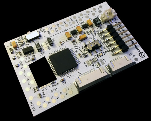

    Non so dove altro postarlo, quindi lo posto qui.
    Sul forum Xecuter Ubergeek ha postato questo:
    "because unlike certain Italians like yourself we don't release shit half assed just to swing a dick saying woo hoo look at me im awesome - now buy my piece of half working shit because im soo cool. We do things right around here - for 10 years now. So go take your toys, put them back in your pram and piss off back to the Wii / PS3 Scene where they all fcuk each other over like animals.
    btw - here's a pic of CoolRunner v2 Lite Edition (Beta) that doesn't exist
    Now I'm asking you politely to go XXX yourself, silly troll
    Xbox Back-up Creator 2.9 build 0421-crv2_lite.jpg"

    Ovviamente, l'ho postato per le foto del CRv2
