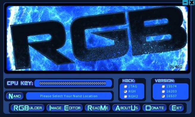

Il nand builder RGLoader (Reset Glitch Loader) si aggiorna alla versione 0v400 Beta, per supportare il kernel 16537.
Tale applicazione serve per 'trasformare' la vostra console RETAIL, in una DEVKIT con funzioni base del Devkit appunto, cosa non possibile quando si crea un freeboot con l'ottimo Xebuilder.

This doesn't mean that I haven't been updating RGLoader for my own uses and adding features,
it just means I didn't feel like putting in the effort to make it usable for the general public and releasing.
I've seen a lot more activity in the #RGloader channel on EFNet and on the forum with people asking for a new update.
I have no problem putting the work in when I know it's not going to waste, so these past couple weeks I have been porting some of the new features in RGBuild++ to this older builder just so you guys can enjoy what we have so far and run a much more stable kernel.
I'd like to conclude with, don't be fooled and think that just because the builder looks
the same that the xbox side hasn't changed. Please try out some of the new features added
and PLEASE leave feedback in the shoutbox at rgloader.com with any problems or successes you have had.
This lets us know that there are still people out there that have use for a devkit kernel on a retail xbox.
