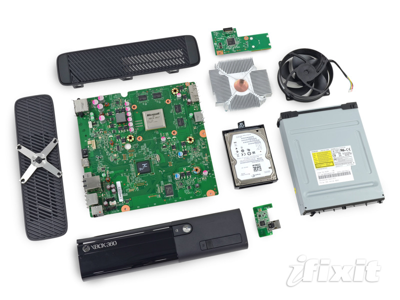

Xbox 360 E (nuova) smontata - teardown
Allegato 11509
[url=http://www.ifixit.com/Teardown/Xbox+360+E+Teardown/15062/1]Xbox 360 E Teardown - iFixit[/url]

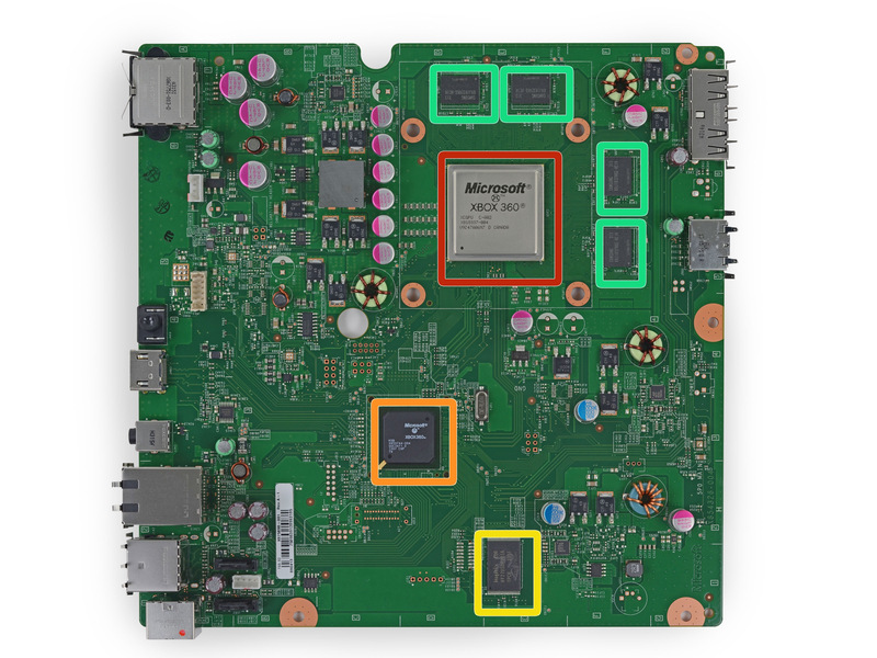

GlobalFoundries (joint venture of AMD and ATIC) XCGPU SoC (combination of the Xenon CPU and the Xenos X818337 GPU onto the same die, with eDRAM in the same package)
Microsoft X850744-004 south bridge
Hynix HY27US08281A 128 Mbit (16MB) NAND flash
Samsung K4J10324KG-HC14 1 Gb GDDR3 SDRAM (total of four = 4 Gb = 512 MB)
fonte:[url=http://team-xecuter.com/forums/showthread.php/136553-Nex-Xbox-360-revision]Nex Xbox 360 revision[/url]

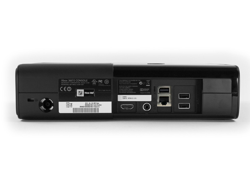

Le USB ci do o eccome... Alla fine che è. Un restiling??
