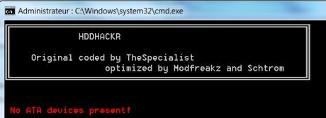

HddHacker supports two flashing modes, Auto and Manual. Typing HddHackr at a DOS prompt
will start auto mode. In auto mode all hard drives will be detected automatically.
