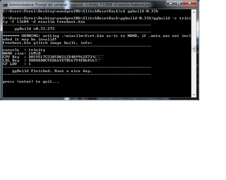

- on the command line type, for example:
example - if you provided keys in appropriate text files
ggBuild.exe -c falcon -d myfalcon myfalconout.bin
-c falcon = use falcon bl and patch set
-d myfalcon = a folder is present called "myfalcon" with per machine files
myfalconout.bin = the file that will be produced
- type ggBuild.exe -? for command line info
Example:
-take original console dump, put it in mytrinity folder as nanddump.bin
-set CPU key and 1BL key in ini file, and set CF LDV to whatever highest number CF LDV shows in flash tool on nanddump.bin
-use flash tool to extract fcrt.bin and fcrt.bin.meta via security files (set ibuild compat files option), and put those in mytrinity folder
-build (ggbuild.exe -d mytrinity -f 13599), flash and hopefully life is good
