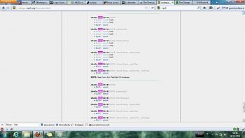

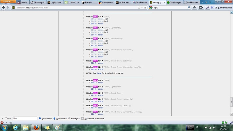

    Ecco la lista dei masterizzatori compatibili con iXtreme Burner Max-immagineets.jpg
    purtroppo sembra proprio siano modelli diversi,questi sono firmware alternativi
    qui c'è una discussione interessante:
    [url=http://club.myce.com/f44/liteon-124-234-324-524-624-help-my-brain-explodes-273574/]Question: LITEON 124/234/324/524/624... help! my brain explodes... - Club MyCE[/url]
    il post 47 in particolare che riporto qui:
    Codice:
    Quote:
    Originally Posted by whitewolf573 View Post
    I have been reading this post , but i have a dude. I have been searching in this forum & google,but i didn't found anything.
    The iHAS624,have two versions ( A and B), no?
    anikk, in one post (the last list of iHAS models) of this topic worote:
    iHAS624-xx A: LS LT SE (orig. design / MT1879LE)
    So model A has a MediaTek MT1879LE.
    I understand there is also a model B
    LIGHTNING UK! said in one post that he bought a lite-on iHAS624, that was iHAS624-T32 B. (UPC: 8 44149 00653 6 / EAN: 4 718390 02772)
    But he didn't say what chipset had.
    The B model is also a MediaTek one ?
    What is the difference between both models A, and B ?
    I beg yer pardon??? You must have been paying a lot of attention while doing all that reading
    Your questions have been answered twice in this thread, in the very 2 posts previous to yours!
    'A' chipset : MT1879LE
    'B' chipset : MT1839LN (all B drives use the same chipset).
    What's the difference? - Different chipsets to start with obviously, and probably some changes in the electronic circuitry due to that, and maybe even a different OPU than the one in the A series ... point is you can't crossflash in between 'A' and 'B' drives, unless you hate your drive and you want to kill it ...
    [url]http://club.myce.com/f44/ihas124-19-a-306129/[/url]
    Ultima modifica di guerrierodipace; 18-10-11 alle 08: 59
