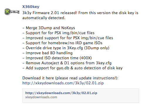

3k3y Firmware 2.01 released! From this version the disk key is automatically detected.
- Merge 3Dump and NoKeys
- Support for for PSX img/bin/cue files
- Improved support for for PSX img/bin/cue files
- Support for homebrew/no IRD game ISOs
- Override drive type in 3Key.cfg (3Dump only)
- Improve bad BD handling
- Improved ISO detection time (400X)
- Remove Autoeject & D1 options from 3key.cfg
- Add support for gyo.db & auto detection of disk key
Download it here (please read update instructions!):
[URL="http://xkeydownloads.com/3k3y/02.01.zip"]http://xkeydownloads.com/3k3y/02.01.zip[/URL]
Download it here (please read update instructions!): [url]http://xkeydownloads.com/3k3y/02.01.zip[/url]
