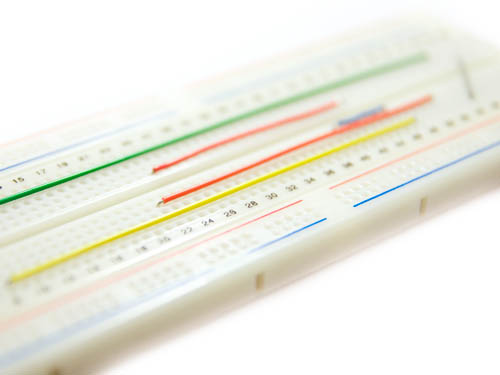

Wire up both nands using e.g. jumper wires and you can easily switch between nands.

TnX Judges for your kindly reply.
Ok, Teensy + cut 5V Bridge + Bridge 3V + No Reg. + external power supply (this is already mine configuration, I already made NOR dump with this configuration).
But, what e.g.? something like this? Allegato 15604
Is there a way for DUAL NANDs and not a SBE?
This night I'll try according to this: [url]https://github.com/hjudges/NORway/bl...terEdition.jpg[/url]
+ NO WP
+ NO TRISTATE
+ CE to GND
TnX again
