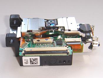

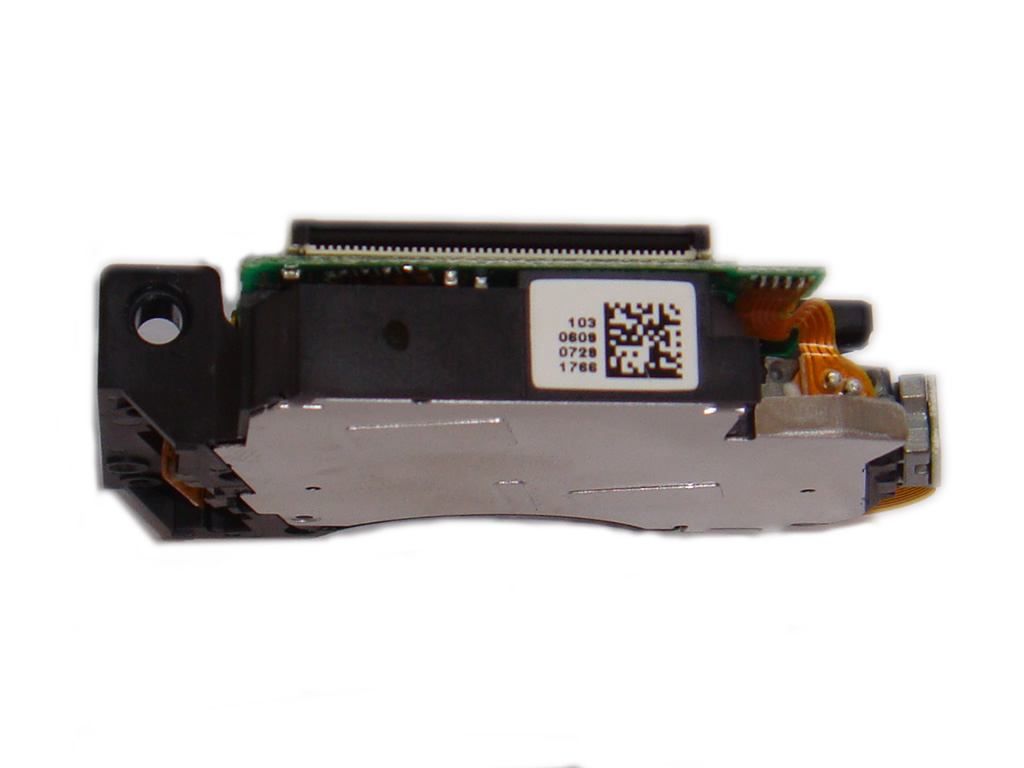

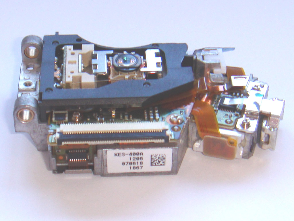

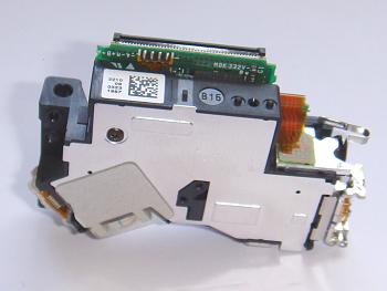

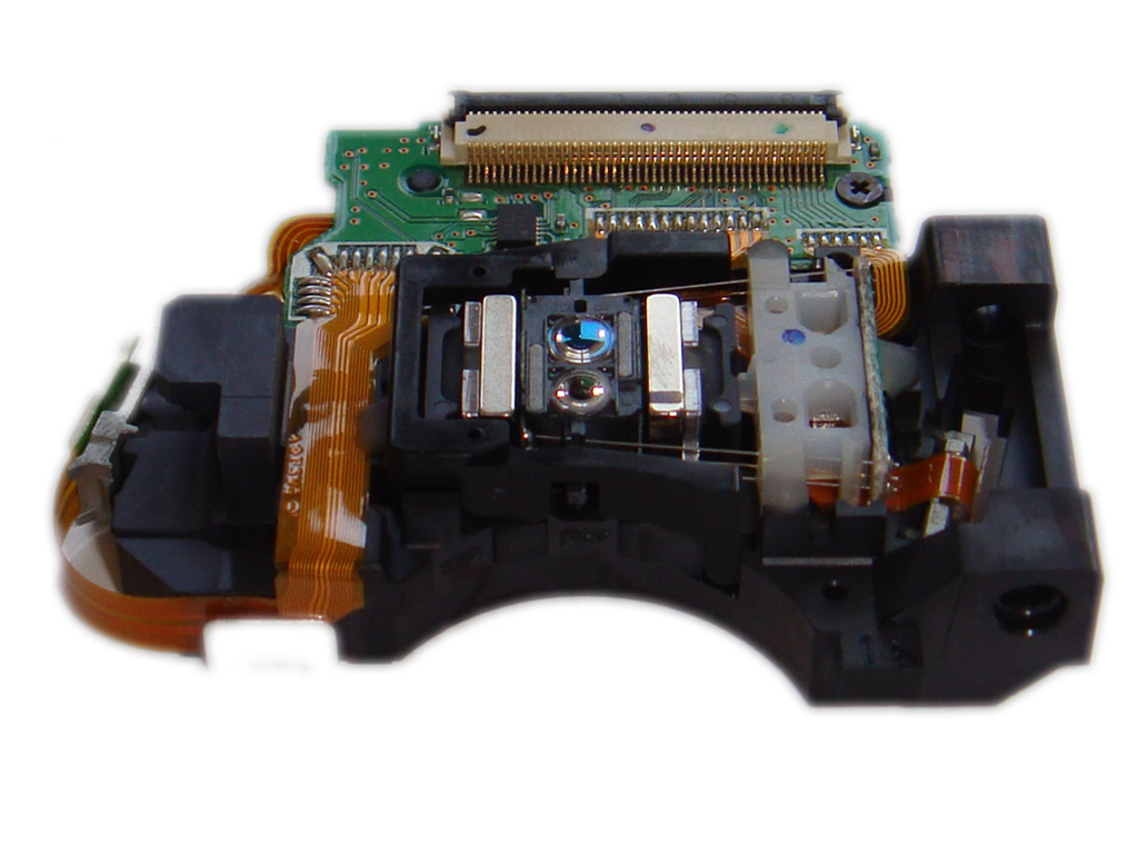

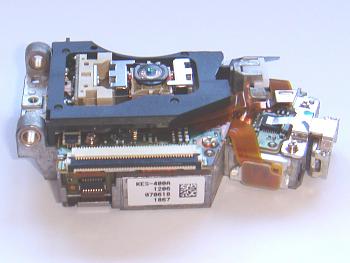

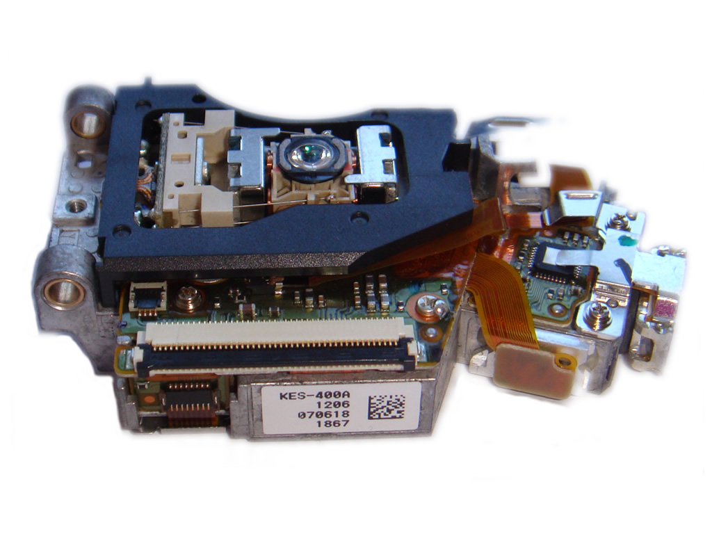

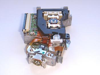

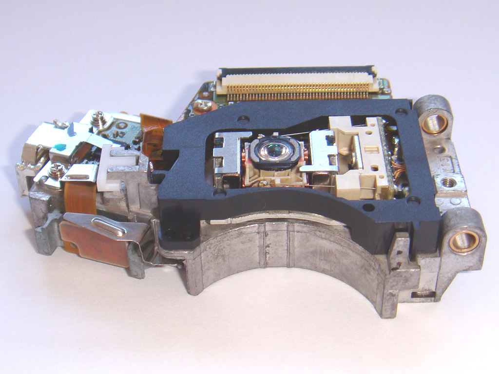

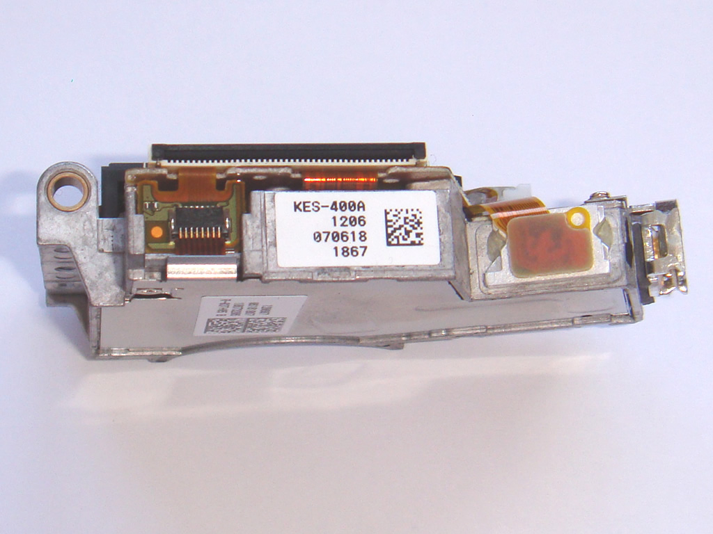

    KES-400A
    Tabella lenti laser PS3 FAT-ps3-laser-kes-400a1.jpgTabella lenti laser PS3 FAT-ps3-laser-kes-400a-side-lower.jpg
    Tabella lenti laser PS3 FAT-ps3-laser-kes-400a-side.jpgTabella lenti laser PS3 FAT-ps3-laser-kes-400a-rearside.jpg
    Tabella lenti laser PS3 FAT-ps3-laser-kes-400a-offside.jpgTabella lenti laser PS3 FAT-ps3-laser-kes-400a-label-zoomed.jpg
    Tabella lenti laser PS3 FAT-ps3-laser-kes-400a-label-serial.jpgTabella lenti laser PS3 FAT-ps3-laser-kes-400a-front.jpg

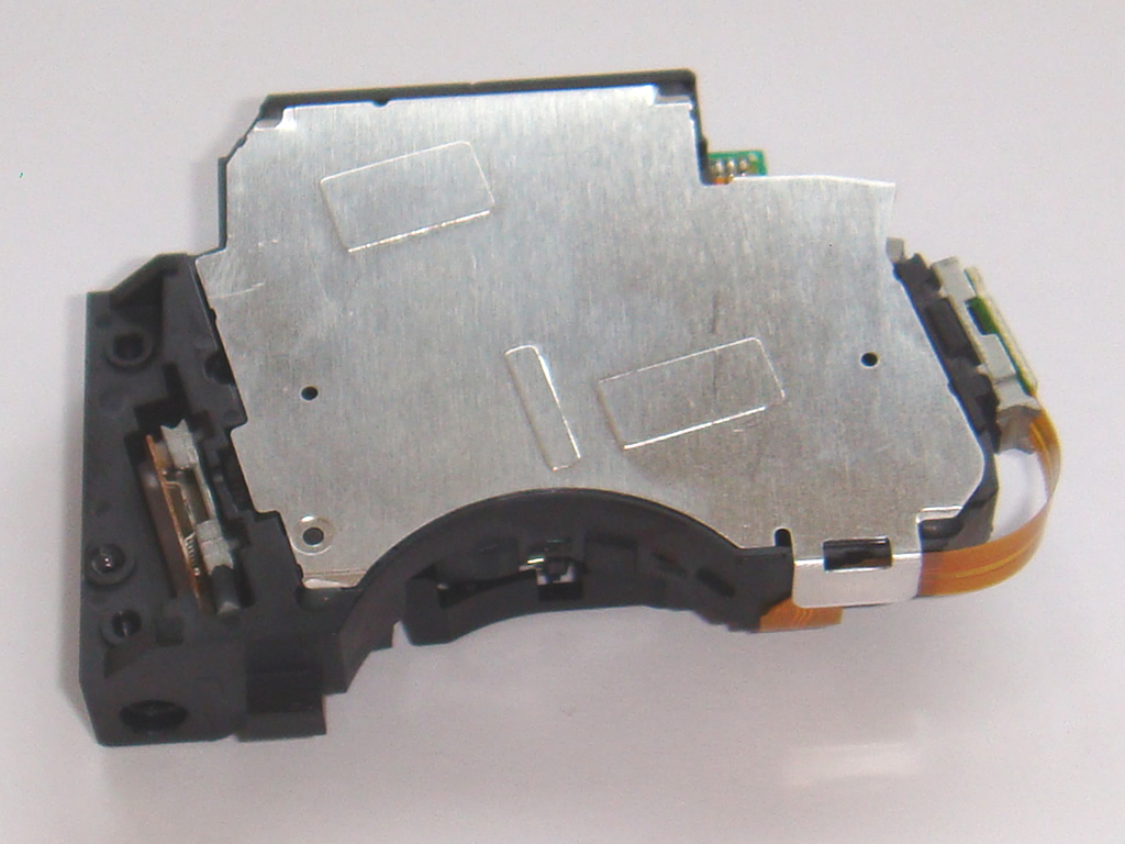

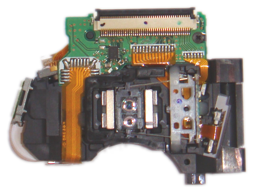

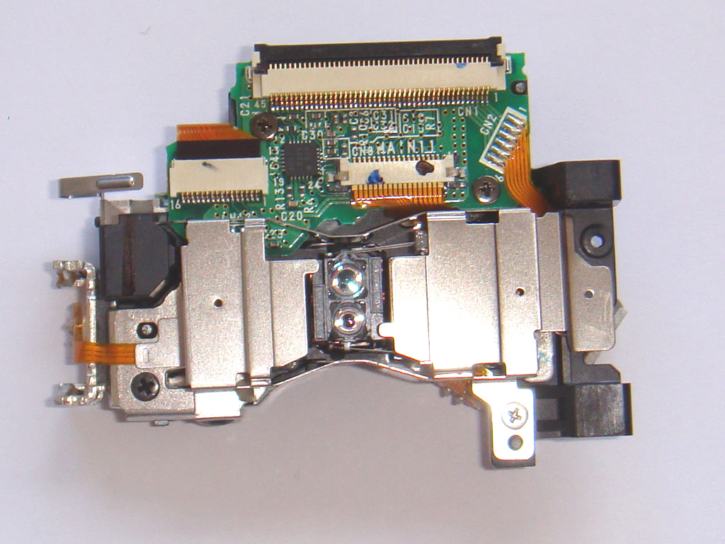

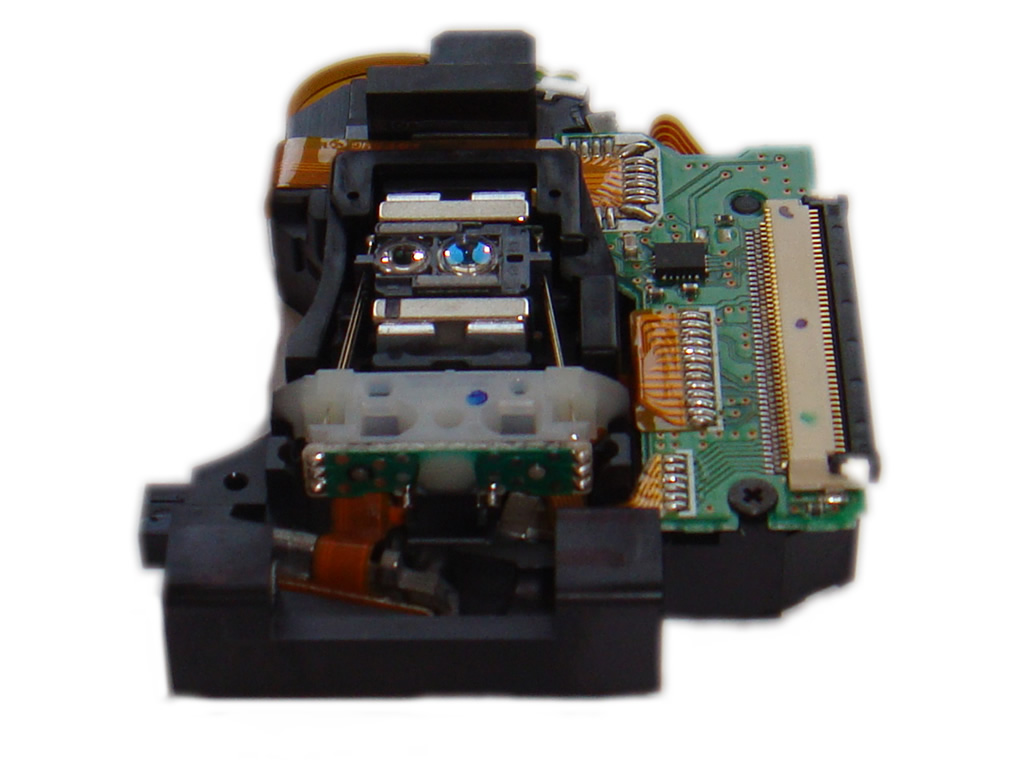

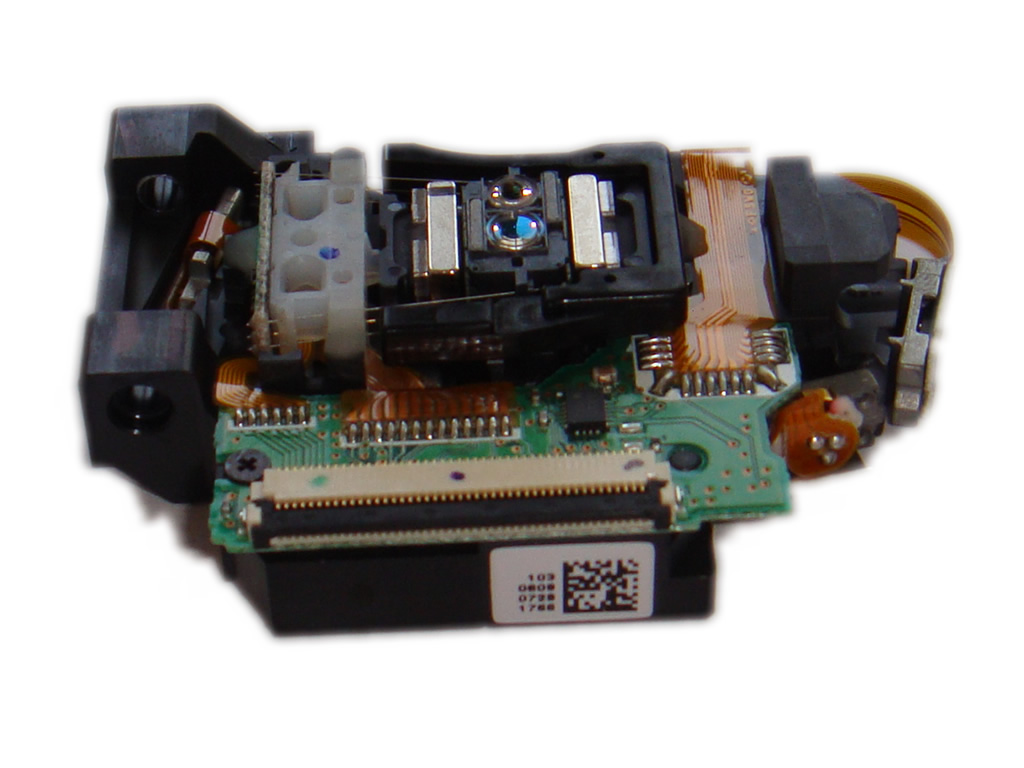

    KES-410A
    Tabella lenti laser PS3 FAT-ps3-laser-kes-410-top.jpgTabella lenti laser PS3 FAT-ps3-laser-kes-410-offside.jpg
    Tabella lenti laser PS3 FAT-ps3-laser-kes-410-front.jpgTabella lenti laser PS3 FAT-ps3-laser-kes-410-underside.jpg

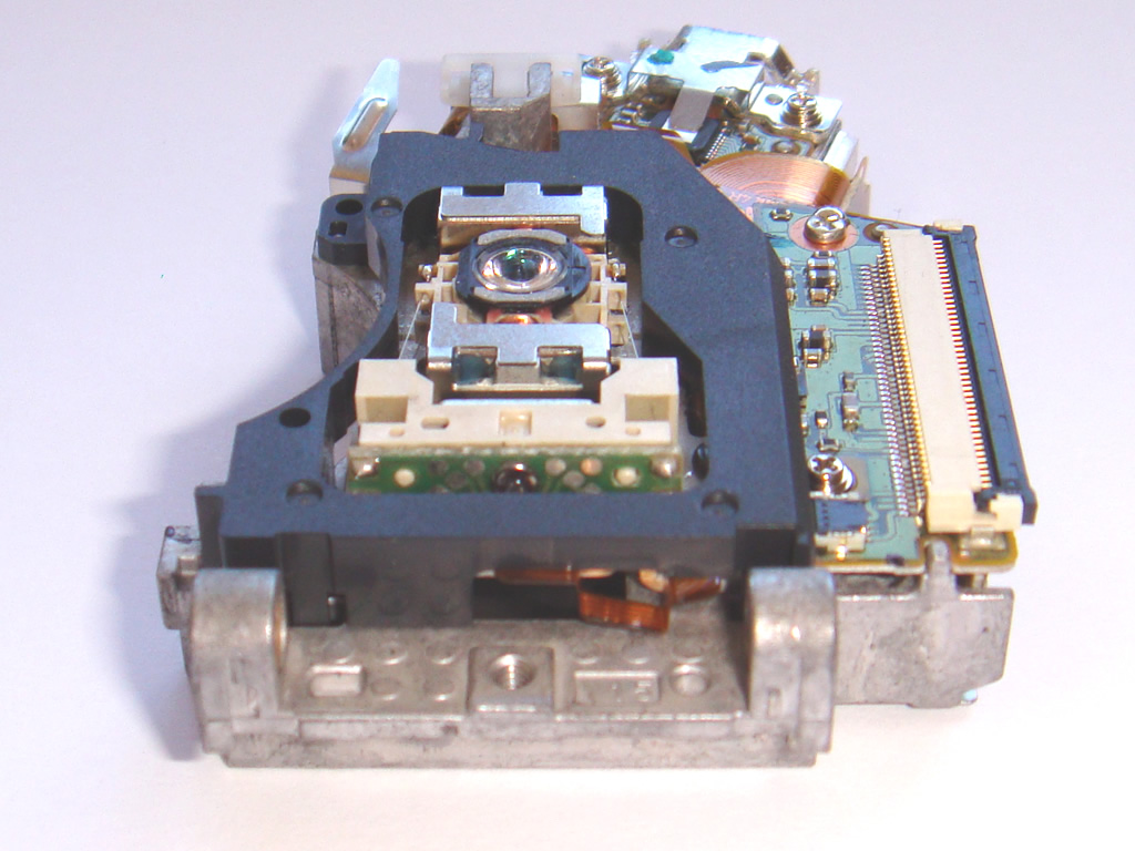

    Allego anche alcune foto del laser per SLIM KES-450A
    Tabella lenti laser PS3 FAT-ps3-kes-450-slim-laser.jpgTabella lenti laser PS3 FAT-ps3-kes-450-slim-laser-offside.jpg
    Tabella lenti laser PS3 FAT-ps3-kes-450-slim-laser-rear.jpgTabella lenti laser PS3 FAT-ps3-kes-450-slim-laser-side.jpg
    Tabella lenti laser PS3 FAT-ps3-kes-450-slim-laser-underside.jpgTabella lenti laser PS3 FAT-ps3-kes-450-slim-laser-underside1.jpg
