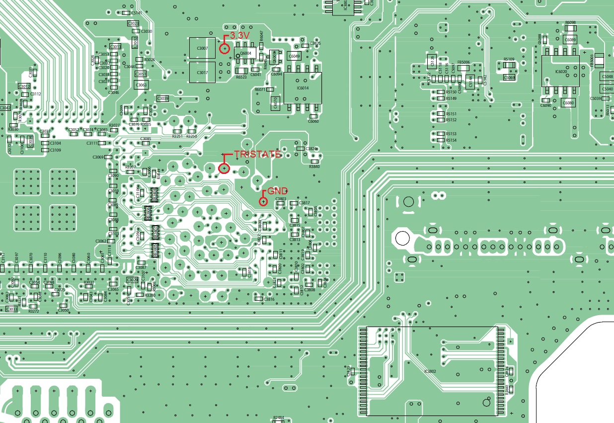

    Va bene se li collego a questi punti? (SEM-001)
    E poi non ho capito cosa devo collegare al Tristate , sapresti aiutarmi ?

    Certo che fai domande assurde...chiedi se la 3.3V č uguale alla 3.3V, boh chissā forse si non so ora ci penso.
    External Powering Notes
    <judges> nand powered with 3.3v by atx doesnt work
    <judges> nand powered by teensy requires huge delays to work kind of reliable
    <judges> teensy powered by usb, nand powered by external psu with 2v works like a charm..
    <judges> thats why nandway worked for me.. it's slow. my own version is almost twice as fast and only worked on my first nand. second one always gave errors..
    <judges> powered by teensy seems to be right on the edge of whats still working
    <judges> but only with 10ms delays between page reads..
    <judges> current power draw is 1.13amps at 2v
    <judges> nand control lines are pulled high by starship and teensy isnt able to pull them low
    <judges> 2v-2.5v works fine
    <judges> stops working at 2.8v
    <judges> it seems to be kind of variable.. <@eussNL> 1.5Amps at 2.5V is more than enough, right judges ?
    <judges> using my version of nandway you'll need 1.84A@2.5V
    <judges> using the original one you'll need 2.5A@2.5V
    <judges> my version drives i/o lines differently
    <judges> also original doesnt even work at 2.5V
    <judges> 1.7V still works fine for both versions and only takes max 1.2A
    <judges> as i said, original version doesnt work at 2.5v
    <judges> 2.2v max

    Se alimenti esternamente il tristate non lo devi mettere a massa.
