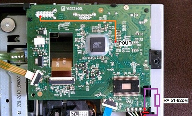

If your drive is spitting out the tray after Winbond unlock it is possible to solve the issue cutting a wire, adding a resistor and soldering Pout to Eject. Follow this picture's schematic.
If the drive tray is too fast use a 100 ohm trimmer, start to test from 60 ohm and increase slowly that value.
