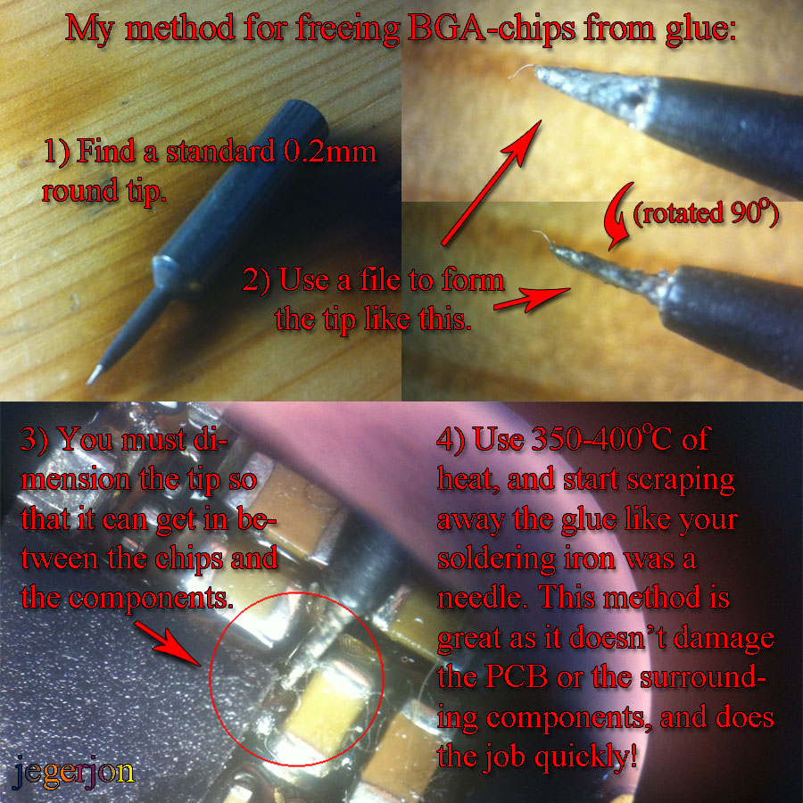

Vi linko alcuni tips trovati in forum molto tecnico per cellulari:
I have tried many solvents thinner,acetone,dichloroethane(harmful),paint stripper,bga ic athesive remover(Made in China) all this are good for cleaning the ic after you unsolder it from board,it will never soften under the ic.
I have told many times use heat gun with 180C of heat full air flow and a needle or dental tool and clean around that glue then unsolder the ic with 280C to 300C of course this temps are low because i not use board holder,if you use board holder then you need more temp,good luck!
If there is some chemical that will eat that black s..t under the ic let me know.
As for the way to remove the resin, I do about the same as Wites. ~180 degrees from preheater, and a little less heat from air gun but with maxium airflow. Then i pick it with a sharp tool. I find this method rather quick, as the huge air flow helps clean the area when you work through it.

Allegato 12632Citazione:
