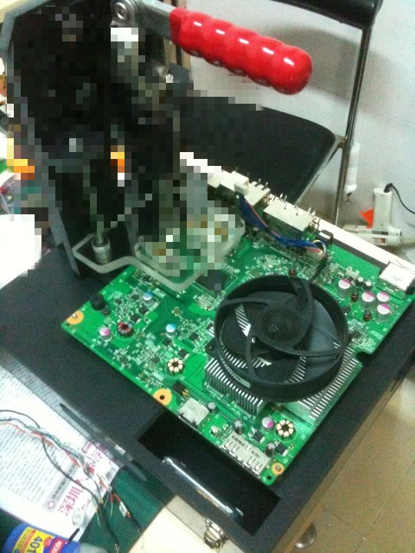

Allegato 5096Allegato 5097Allegato 5098 you think this will boot corona v2 ???

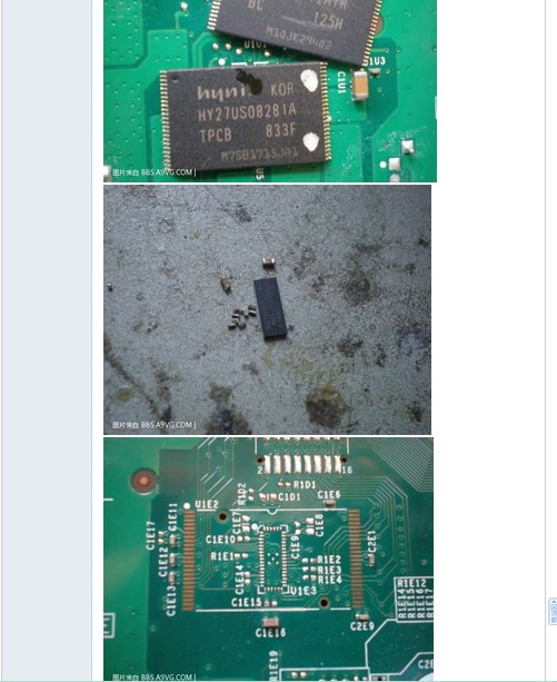

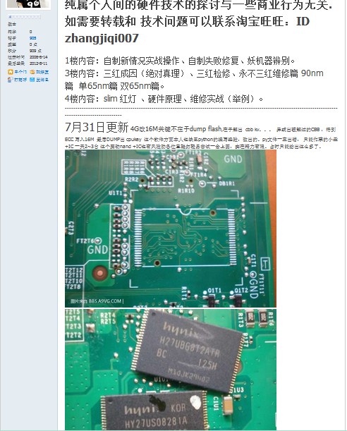

Hello everyone, sorry I don't speak italien but what I can tell you is that orkid1818 read the information on the forum where zhanjuqi007 wroth about all his tests, also on this same topic he gave out his 64Mb nand file and his cpukey to prove his work. Now orkid1818 is trying to do this be he can't because he doesn't know how to do it.
Anyway for everyone else here is how it should be done
you need to transform your corona v2 motherboard like if it was a corona v1, both motherboard are the same except they have some component that are different around the nands
Here is what you have to take off:
TOP MOTHERBOARD
-the phison chip
-R1E1, R1E2, R1E3, R1E4
-C1E6, C1E7, C1E8, C1E9, C1E10, C1E14, C1E15, C1E16
BOTTOM MOTHERBOARD
-the corona v2 nand
-R1R1, R1R2, R1R3, R1R4, R1R5, R1R6, R1R7, R1R8, R1R9, R2R2
-C1R1, C1R2, C1R3
This is what you need to solder back on:
TOP MOTHERBOARD
-the corona v1 nand with the corona v2 ecc
-C1D1, C1E17
-R1D1 & R1D2
BOTTOM MOTHERBOARD
-R2T1, R2T2, R2T6, R2T7, R2T9, R2T10, R2T11, R2T14

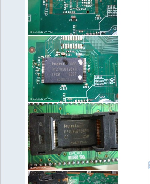

Cioè praticamente per fare il dump si deve farlo direttamente dal chip smontato, dopodichè bisogna rimettercene uno da 16mb con l'ecc iniettato delle v2 per recuperare la cpu key..

From another V1 motherboard maybe?
Yeah that's one way of doing it, using the components from another v1, but I'm currently checking the values of the ones we have to take out from the corona v2 to see if those can be used
Ok, zack thank you , but for read the v2 nand we should soldering it on V1 motherboard right??

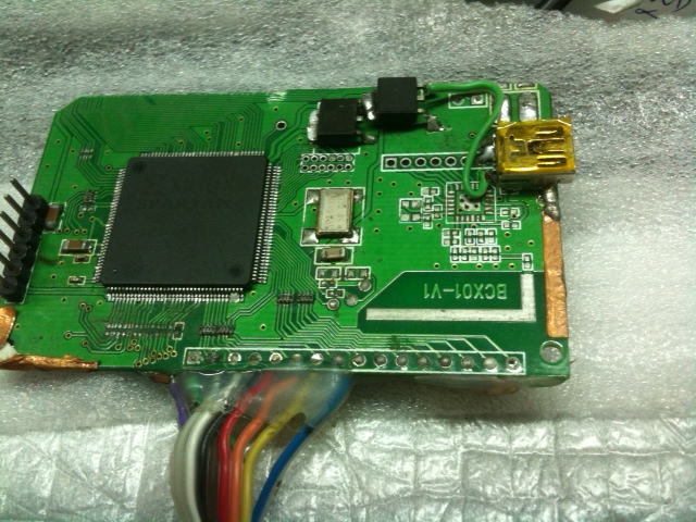

Allegato 5131Allegato 5132 :welcoming: My new toy .
Thanks but Zhangjiqi007 did most of the work, we gave information about the chip and idea about puting the components back, the rest is all Zhangjiqi007.
I'm still trying to understand how he extracted the nand information to create ecc but it's really hard to speak technical with a chinese.... the translating doesn't mean anything :s

Hmm don't even understand why it is hidden... Zhangjiqi007 has given out all the pictures about his work so why are you hidding your "new toy"
Still :WIP......
