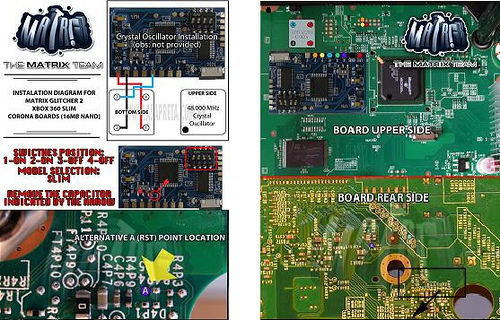

Matrix Glitcher II firmware upgrade v1.5
- Added Corona motherboard compatibility (see installation
diagram at [url=http://infinitymod.com]The MATRiX Team - Home of the matrixglitcher360 and matrix nand programmer[/url] ).

ON OFF ON OFF PHAT RGH 2.0
ON ON OFF OFF CORONA
