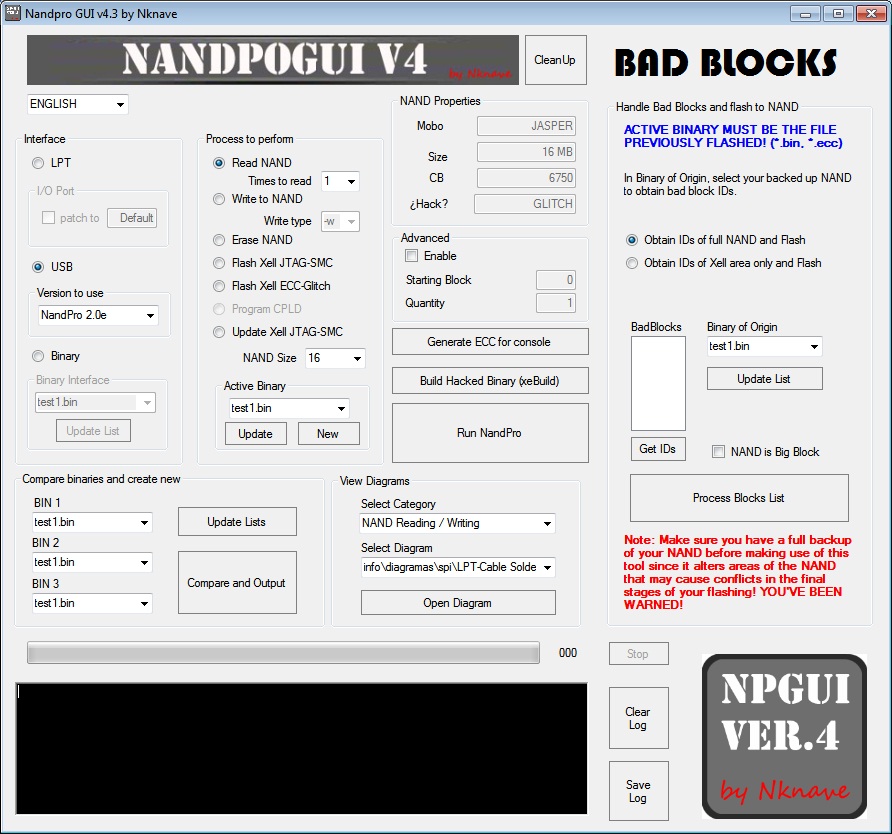

The main goal of this tool is to perform all operations to the Xbox 360's NAND
when you plan to install RGH or JTAG-SMC, do it all in one window and leave the
rest when xell is loading on your machine.
I recomend xeBuid GUI v2.04 by Swizzy to complete the rest of the tasks if the
builtin xeBuildGUImini_v2.0 is not enough for you.
The main idea and how this tool is focused:
1.- Choose your NandPro Interface (patch LPT port if Necessary)
1a.- Choose version of NandPro in USB mode
2.- Read NAND 3 times (2mb if your interface is LPT)
3.- Compare 3 nands y create new to use as your main backup
(It is not a very robust comparison but it does the job)
4.- Flash Xell JTAG-SMC or ECC for the RGH
4a.- This tool is capable of building a valid ECC hacked images defined by
the active binary selected, this can be done with the button I added
or you may be prompted if you choose to flash ECC and the ECC is not
either selected or created. You will be prompt to build it prior flashing.

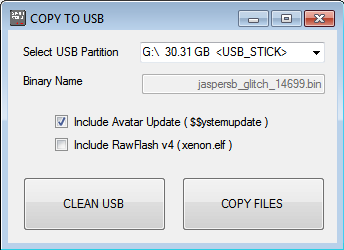

- At the end it may ask you if you wish to put this file to a USB of choice
- Includes checkbox to add Avatar Updates
- *Optional Avatar Update for 14699 install to "usb_files\$$ystemupdate"
- Includes checkbox to add RawFlash v4 (if needed)
- If you select to add RawFlash v4, will copy binary as nandflash.bin
else as updflash.bin

Information about the progressbar on NandPro:
The progressbar is only a simulation/guestimation of the event based on a timing
event. First will verify against 1 block on nand and define the time it took to
perform the task, than that is the time it should take for the progress bar to
increase and display current block processed(currently block display may not be
the exact same block being processed but it is close to what it should be).
