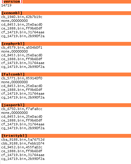

- Updated: You can now also build Glitch type freeboot images for xenon
** NOTE: This will use CB 1940, if you want to use a different CB version you'll have to manually edit the glitch.ini with both new version to use AND the CRC value, aswell as add the new CB file... **
