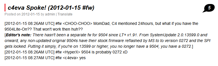

[2012-01-15 04:09AM UTC] #c4e <c4eva> LT 3.0 for 0272/0225/0401/1071 slim liteons and a new JF to be released within 24 hours!
Iniziate ad aprire le consolle .....
un altro estratto da irc
Allegato 2228
Addio 9504 ^^
