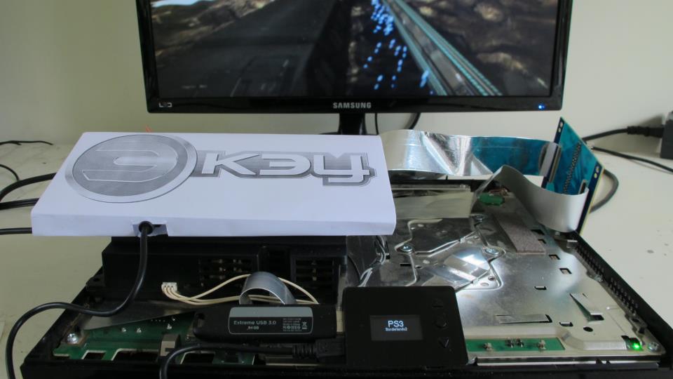

Grazie alla segnalazione di xboxbs, da [URL="http://www.eurasia.nu/"]EurAsia[/URL] si viene a conoscenza dell' imminente arrivo per primo ODDE per PS3 dallo stesso team produttore dell'Xk3y
Il sito [URL="http://www.ps3crunch.net/forum/threads/4969-CONFIRMED-3KEY-Arriving-soon-A-PS3-Blu-Ray-ODD-Emulator-device"]Ps3Crunch[/URL] ha scoperto che :
#1 - The team for now is only releasing one picture regarding 3K3Y, but are hoping for an 'end of the year' release.
#2 - It is full hardware interface, not a dongle, but currently you need CFW v3.55 to dump the BD drive key, after that you can update.
#3 - It will be complete ODD Blu-Ray emulator, allowing even the feature to rip your original PS3 game discs to your external HDD.
#4 - Due to the nature of design, you will be required to open your PS3 to install it, but I been told NO SOLDERING is needed.
#5 - More info will be release later, but for now any more pictures and videos are PRIVATE and been shown only to trusted long-time resellers.

AGGIORNAMENTO : il 3k3y leggerà le iso . Per effettuare un backup 1:1 è possibile farlo da linux con il comando "dd if=/dev/cdrom of=game.iso"
AGGIORNAMENTO 2 :
FEATURES
Play your PS3, PS2 and PSX games from any USB media!
No custom firmware required for operation* – you can update to the latest official firmware for PSN access
Integrated game ripper
User friendly intuitive interface
no soldering required
Multi-language support
Compatible with both Fat and Slim models
Supports most file systems, including NTFS, EXT2/3/4, and Mac OS X Extended
High speed USB2 interface
Powerful embedded Linux system running from Micro SD card (included)
Linux firmware fully updatable from USB media
FPGA fully updatable from USB media via built-in, in-system JTAG programming
Recovery mode – it is always possible to recover from a bad flash Update your PS3 as normal, no CFW or game patching required
Pass-through mode. (Use your PS3 in “normal mode”)
* Currently firmware 3.55 is required for exctracting the drive key. Once the key has been extracted the PS3 can be updated to any official or custom firmware. We are working on hardware methods for extracting keys from PS3′s already on 4.x firmware.

3k3y status update!
- Final hardware verification will start this week. All parts have been tested on development boards so no surprises are anticipated.
- While built-in disk ripping does work, it is too slow to be practical. There is another way which is much faster and can most likely be delivered in a future update, but we will not have time to verify this before launch. So we decided to remove built-in disk ripping from the feature list and put it on the WIP list.
- We have designed and completed software and a add-on board for connecting a PS3 drive to a PC via USB in order to dump games. This add-on board will be a part of the 3k3y kit.
A correction to the 3k3y status update: Built-in disk ripping will not be available on the release hardware. We took the hardware of 3k3y (where it was slow) and put it on an external board (where its blazing fast). This doesn't mean built-in disk ripping will never happen, it is still possible to do via the FPGA at high speeds.
